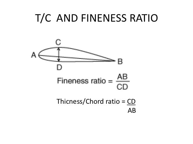

It would appear to be the ratio of chord to thickness. It can't really be anything else, since they're specifying the (2D) cross-section.
In the image below, it's the same as saying AB/CD </= 3.5

ChrisDanger wrote:It would appear to be the ratio of chord to thickness. It can't really be anything else, since they're specifying the (2D) cross-section.
http://image.slidesharecdn.com/8-2-1208 ... 1350604442
hello Chris, thank you for your reply, so the answer should be 100/CD = 3.5 => 100/3.5 ~28.57mm ?
