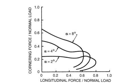

Re: Slip angle under traction
is for a truck tire. So at 2 degrees of slip the traction force doesn't affect the lateral force, but at 4 and 8 degrees it does
