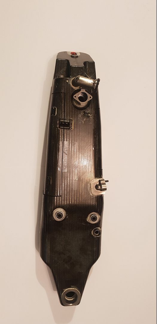

The part below is from the Honda V8 Engine.
Just to give a quick overview - the oil tank is attached to the front of the engine behind the fuel cell. Its job is to act as a storage tank for the engine oil. The base of the tank contains a large outlet that attaches onto the oil pump entry port.It is important this is large and as near as possible to the pump inlet to avoid cavitation. The tank also contains many other ports - an oil drain at the bottom, breather port, oil level port, and return ports from the scavenge pump centrifuge. On the return from the scavenge pump centrifuge - the oil enters the main cyclone within the oil tank. The oil and air mix is then given its final separation treatment using cyclonic separation. Since the air and oil mix enters the top of the cyclone tanks tangentially and at high velocity, rotational effects and gravity work to expel any air left in the incoming oil. The tank contains three cyclones. The main larger central cyclone takes the bulk of the oil from the dry sump system. The other two smaller cyclones take the rest from the pressurized scavenge pump bypass. A unique feature of the Honda dry sump system is that the scavenge rotors compress the outgoing air/oil mixture. A compression ratio of two was chosen and this in turn reduced pump drive resistance by 30% which as a whole saw engine friction reduce by 3KW. However, with this system, if the pump was to take in pure oil - this cannot be compressed, so a scavenge pump bypass was fitted - the outlet from this leads to the two smaller cyclones.
This system although sounds complex shall be displayed later below.
Onto the oil tank - the tank was cut using a 1mm wide blade. Since internal makeup was unknown, a sensible cut plan was chosen to best display all features which could possibly lie within.
The tank below, it measures approximately 650mm high, 180mm wide, and 180mm deep, the round elbow fitting being the main entry at top,
