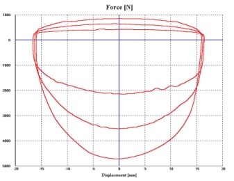

In the dyno curves, wich graph do we have to pay attention to and for what?
These are some examples of what we can see in some machines:
Then there are other (the mechanical) considerations we have to consider. What about hysteresis, dry and fluid frictions contribution, gas preloads, temperature build up, oil seals, etc.

there are other ways to display damper data, which include frequency and/or acceleration.
On an standard damper dyno (yoke drive, sine wave input), I think a force vs. displacement graph (called football or potato graph by some) is the most useful - IMHO.
As you see, that in your example the damper reacts different at the some speed for accelaration vs. deccelaration, leading to a quite high hysteresis in the upper part of the diagram ( I assume it´s the bump side ? ).
So you may have a stiffness "issue" here, can be air inside the damper or insufficient gas pressure compare to the bump damping forces, flex in the damper dyno loadcell or flex of the connection hose, if we talk about a remote canister damper.
It´s basicly a typical graph for a "spring-force" on top of your "damping-force".
This does not need to be a bad thing, on the track, but you will need to keep it in mind, and it makes it a bit difficult to control this characteristics.
I thought you wanted a "D" shape.... :?:
Hi Strad,
I was talking about the general graph (force vs. displacement or force vs. position)
this graph gives you the most comprehensive imformation, as it shows the transient behavior of the damper, and not just the peak values.
What the graph looks like, will depend on the characteristics of the damper. e.g. linear, digressive or progressive damping.
It can look like a "D", if this is good or not will depend from the vehicle, and what you would like to achieve with your choosen damping.
a force vs. displacement diagram for two different dampers.
I guess the first one looks more like a "D", if this is what you mean
and the second one more like a "football/potato" cut in half.
This is why some damper/racing people call it "the football/potato" graph/diagram
I did not wanted to make a reference to the specific shape, just to the way the forces are represented/shown
All application dependent and depends on the style of the design intent....
Most passenger car damper would tend to have asymmetrical "football" shape, biasing more rebound than compression. But that probably won't work if you are designing something to do jumps and stuff...
Typically for work here, the 2 graph that we usually look for is the Peak force vs Peak Velocity graph. There are some weird speed that seems to be the standard that all automotive dampers are tested and benchmarked at. This is typically the graph you can see the "knee" at the damping curve, which shows the separation and transition between high speed and low speed damping. We also use the football curve, which can be useful to identify issues with damper, in lags, cavitation or over/under fill of fluid.
