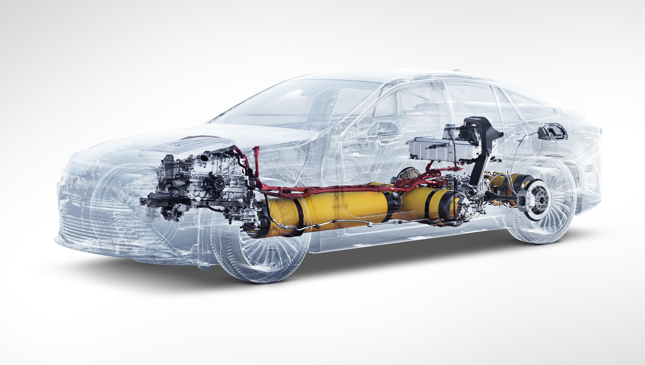

Adding batteries to fuel cells Is Just adding weight, cost and complexity. This isn’t an issue for very large vehicles, but it is for passenger vehicles and race cars (less so cost in the latter example).
Btw, please tell me how you could fit this level of complexity into an F1 car without building an LMP car?
https://www.toyota.com/content/dam/toy ... 6_V002.png
Those huge tanks are only good for 400 miles under normal driving conditions. I’m all for bringing refueling back to F1, but I can’t see FCEV F1 cars happening anytime in the next 20 years.
You're just reiterating the same BS without even interpreting what I said. Again with the dumb hydrogen cylinders...
How else are you going to store enough hydrogen to be useful?
