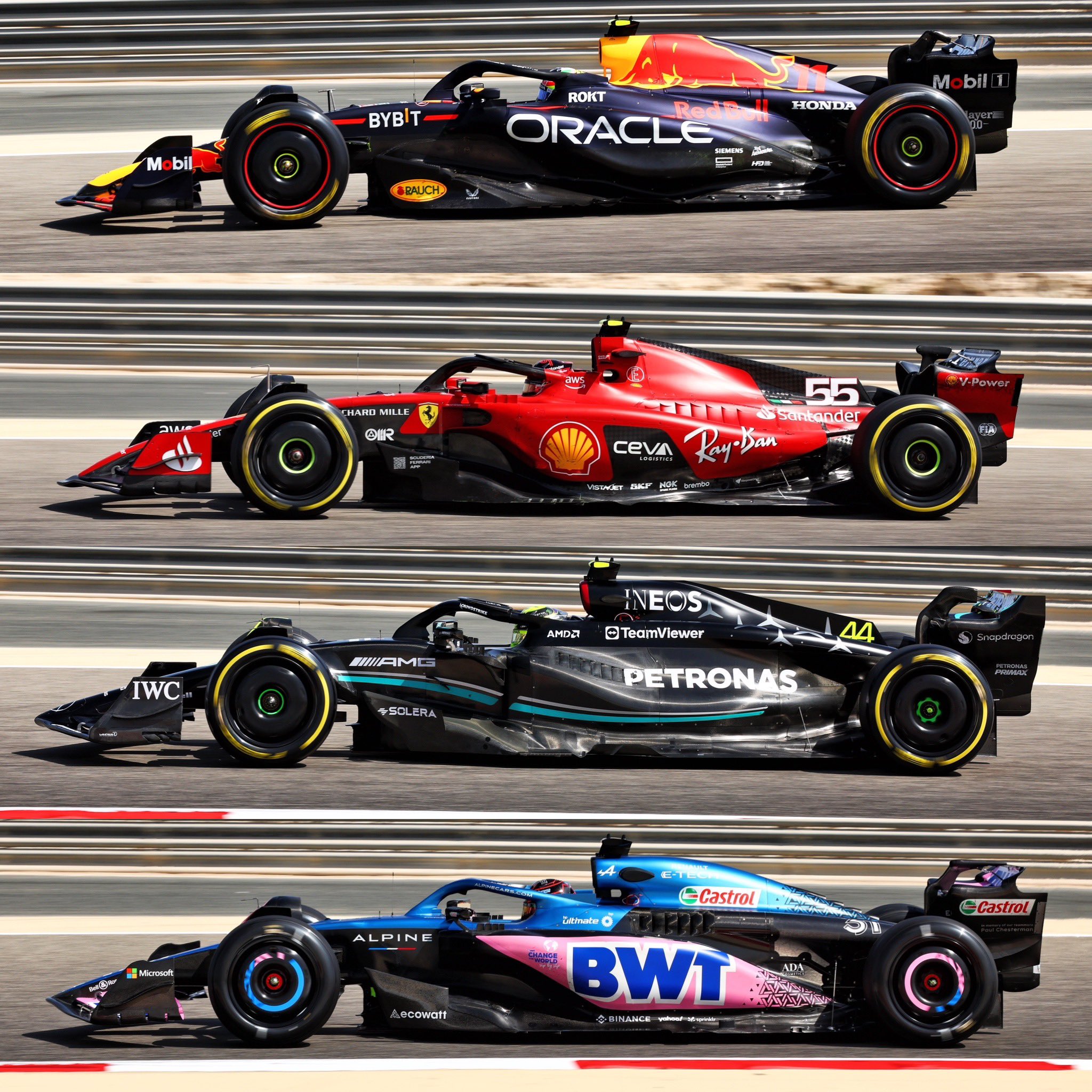

Assuming the picture are similar speed and track position, very clear Alpine needs a higher ride height. Also Williams are quite high. AM and AT are really low.

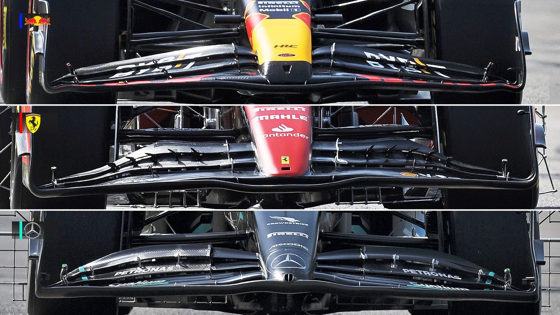

Nice to see the FW area's clearly in comparison. Ferrari has a tiny FW. All top trams and AM reduce the FW area quite a bit.
Williams is the only one I've seen that looks like legality max.

The RB front wing is flattened off so much more than both Ferrari and Mercedes.

SiLo wrote:
24 Feb 2023, 15:24
Could suggest a more forward cp on the floor which is something they likely struggled with last season (a more rearwards aero balance due to the floor)

That's an inherit trait of their floor and diffuser philosophy, floor CoP is around diffuser kick. I wouldn't say their front wing front view surface is bigger or smaller than other two teams, all look quite close, maybe Ferrari is slightly bigger but only just. But different geometries skew the perception.
Bwoah, scratch that, RB wing is definitely smaller in front view, I overestimsted height of outboard section...

Compared to last year it's the biggest visual change on the car.. the fw is massively backed off. Might be somethinf to do with switching from ice skate to their strange edge wing?

Could be, but I wouldn't say so. Front wing affects the entire car and especially now with venturi floors, so if you can reduce their angle and keep the balance that can do wonders for floor performance. The advantage is twofold - you get less upwash and you lose less energy in the air.
This is one of the strange aspects of SF-23 for me, cranking up the central section so much. However, last year F1-75 took the air for the floor seemingly completely from under the nose, so in theory wing flow shouldn't create problems for the floor per se, "just" the floor vanes and sidepods...
