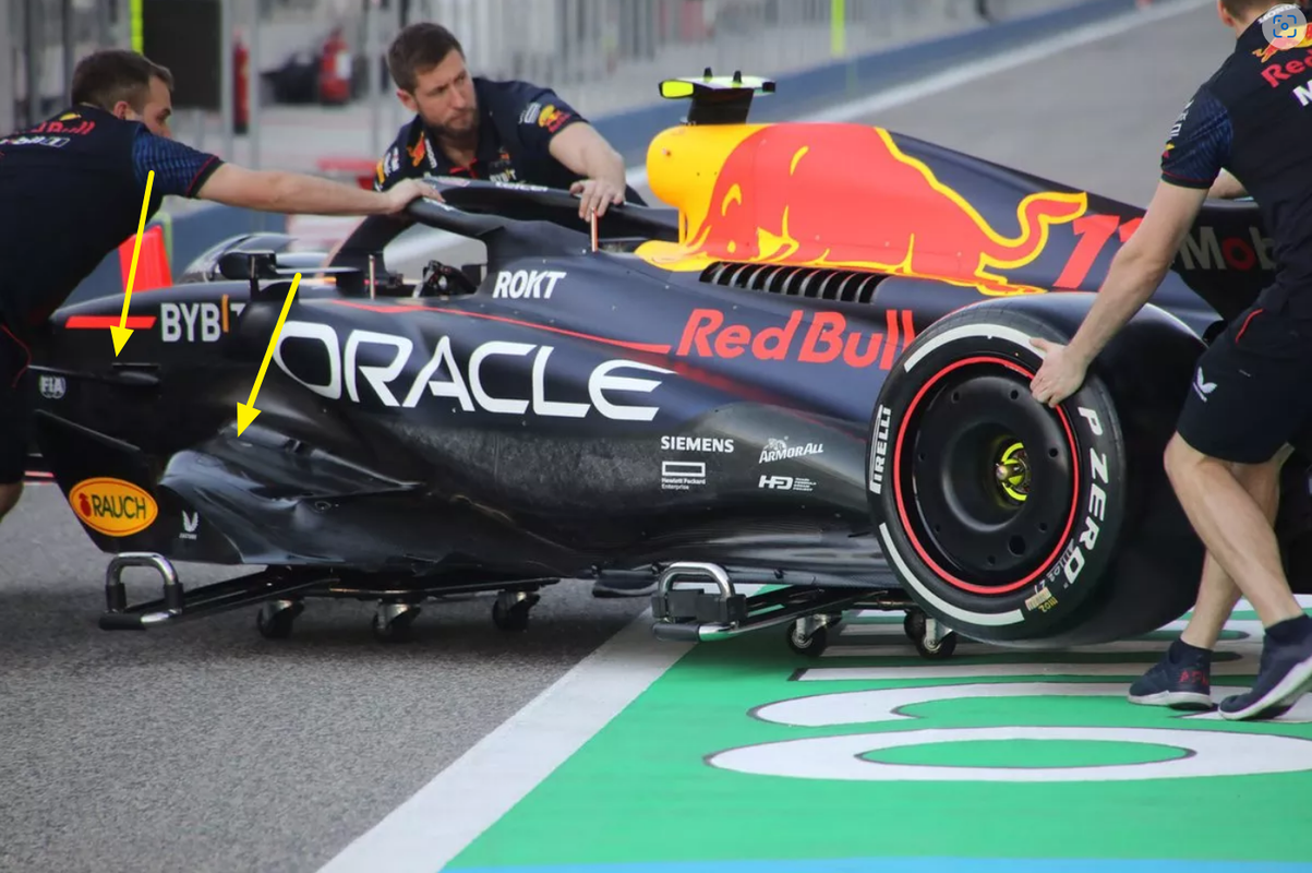

Re: Red Bull RB19
Re: Red Bull RB19
Goblin42 wrote:
02 Mar 2023, 20:30
From this angle it could be deceiving with the upper element looking like the lower element.. If they have removed it, it wouldn't surprise me given Ferrari have also gone in that direction, but I think they haven't
Fabrega image from today seems to show it's still there
The upper t-tray is certainly lower down than it was last year. Similar to AMR23 in that sense
381
Re: Red Bull RB19
It's still there imo. The lines don't make sense otherwise.
