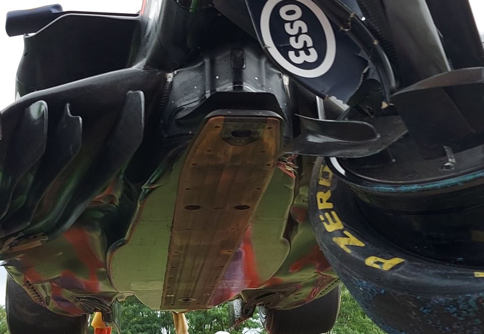

Floor from perez crash

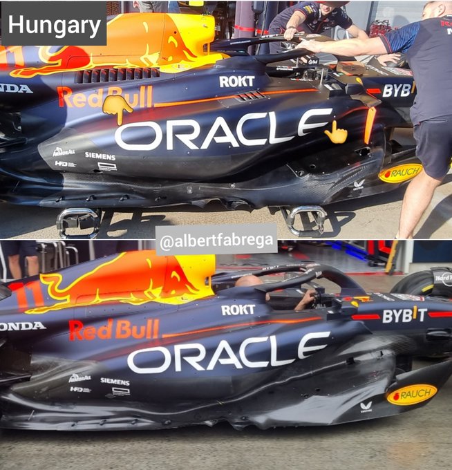

These aluminum bars (sticking out) on the car are gone. No aero rack mounts (likely) as Checo did not run them. Likely it is just for keeping the car straight/stable during transportation.

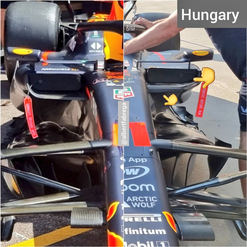

Any Hi-res pictures of the new sidepod inlet?
Tried Twitter and couldn't find anything other than Albert Fabrega pics from yesterday.
Here are some of them ...

Better front-on comparison from The Race

The lack of waterslides are probably because Red Bull are getting good flow to the beam wing anyway, and with such rearward sitting radiators, doesn't make as much sense maybe? Or, and this would be my guess, they prefer the more efficient gentle slope over an aggressive one.
https://i.imgur.com/CppFjLJ.jpeg
The angle is slightly off increasing the visual change of undercut / floor space. But I guess volume wise it's still significantly more

organic wrote:Better front-on comparison from The Race
To me it doesn’t seem they shrank the inlet that much, the lower lip was moved forward and higher but if it creates suction into the inlet the volume of air flowing in will be the same.
Yes it's hard to get what is a truly comparable shot. Hopefully we'll get one that really looks like a good match but so far it's the best I've seen
I agree. It looks a lot smaller when viewed at a low angle, but that might be because the lower lip sits a lot higher than before. I also suspect that they suck just as much air into the inlet as before. They just managed to guide it a bit better downwards.
And it looke like the undercut on the sidepods got even more extreme... Insanity.
