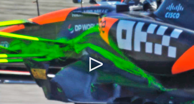

stewie325 wrote:
21 Feb 2024, 13:44
Very interesting how the air separates in two directions around the rear-most suspension arm.
…and the split seems to direct half of the flow into the cooling intake and the other half to the undercut.
