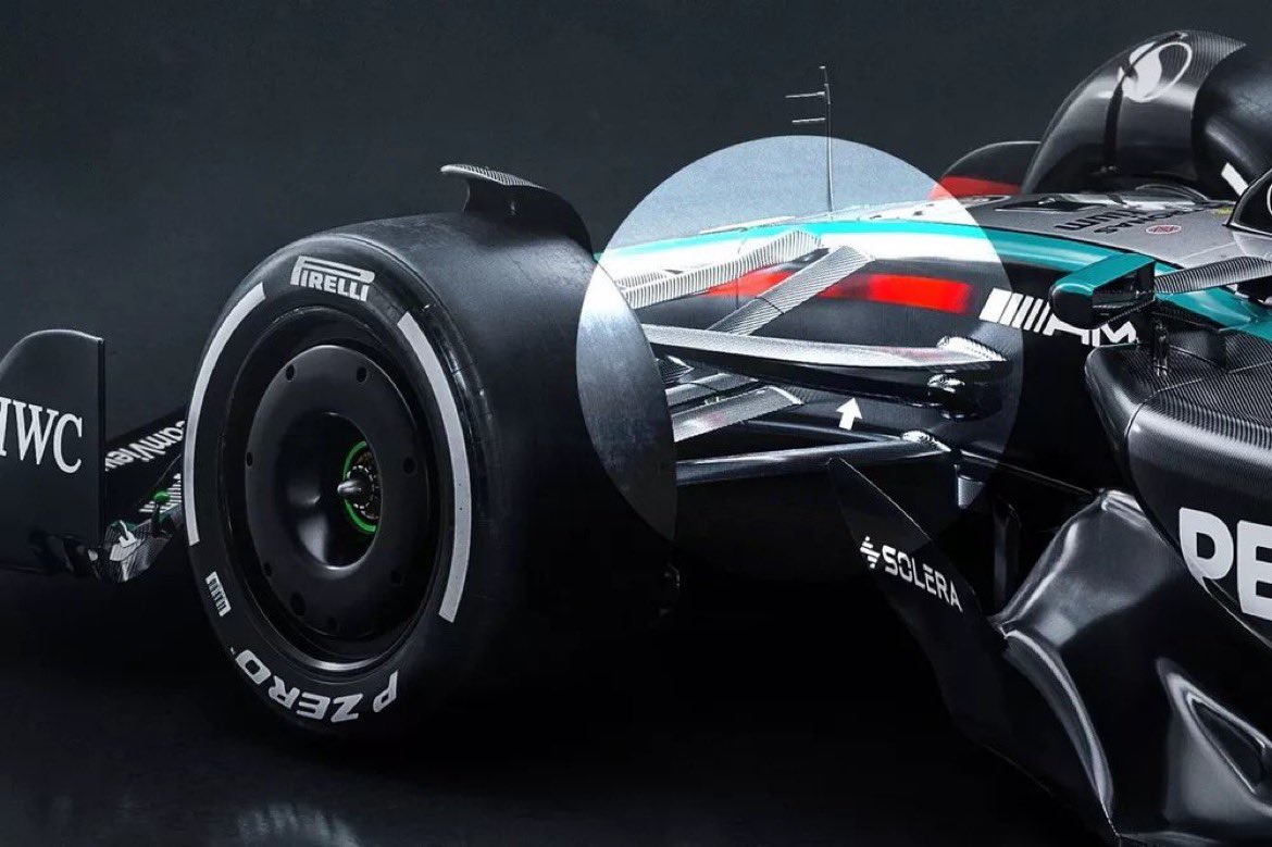

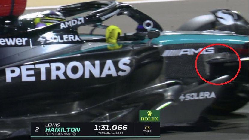

Better comparison images of new suspension locations. Significantly lower in 2nd pic. Interesting
Dr_obbs on twitter for photos
1532
Re: Mercedes W15
Wow, that's not what you want to do unless you aren't sure what to expect from your suspension :shock: Compliance alert, code red level 5 :shock:

The launch renders did show 2 different pick up points and two suspension arm so it seems it was well planned before testing. not sure how is that an alert code red level 5 and whatnot :wtf: ](*,)

but its incredible smart that they can do, instead of building in a flaw that cant be changed the whole year, incredible if they made it modular

Agreed ,seems like a clever way to go testing and learning which development path to pursue

Definitely a good idea, seems like they're testing what amount of anti dive is needed, or maybe they've thought about it being track specific, if its a balance between anti dive behavior and aero, faster tracks with less braking zones might benefit more from the aero advantage than the anti dive advantage

agreed, seems like the renders were showing it the entire time
