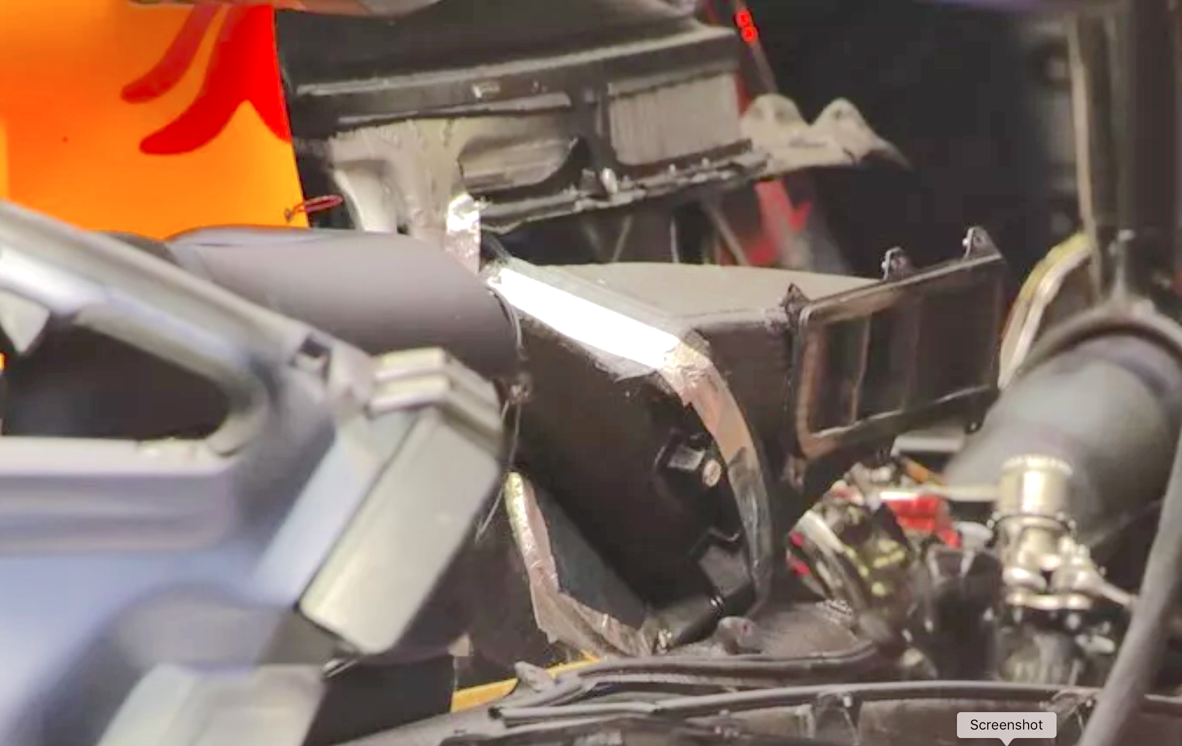

I wonder what they are cooling in this duct. I know they have silver tape which makes it look like a radiator, but I'm not sure it is. You can even see how they've added more tape on the 2nd day.
Is this more of an aero feature that has something small technically being cooled in the duct somewhere to meet the regs?
