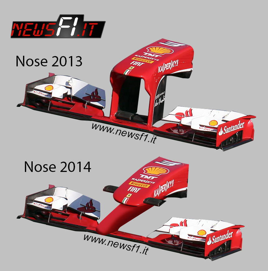

This is how it could be the Ferrari nose like that caterham
:wink: with pylon
http://www.newsf1.it/

zioture wrote:This is how it could be the Ferrari nose like that caterham
http://www.newsf1.it/wp-content/uploads ... i-2014.jpg
How is the wing attached to the nose??
diego1960
Joined: 17 Feb 2012, 17:39
Location: Athens, Greece
Re: Ferrari 2014 Car Pre-launch Speculation
Yes that is illegal, you need 2 pylons. Not to mention ugly.

seahawk
Joined: 19 Dec 2013, 13:42
Could be 2 very tiny pylons.
