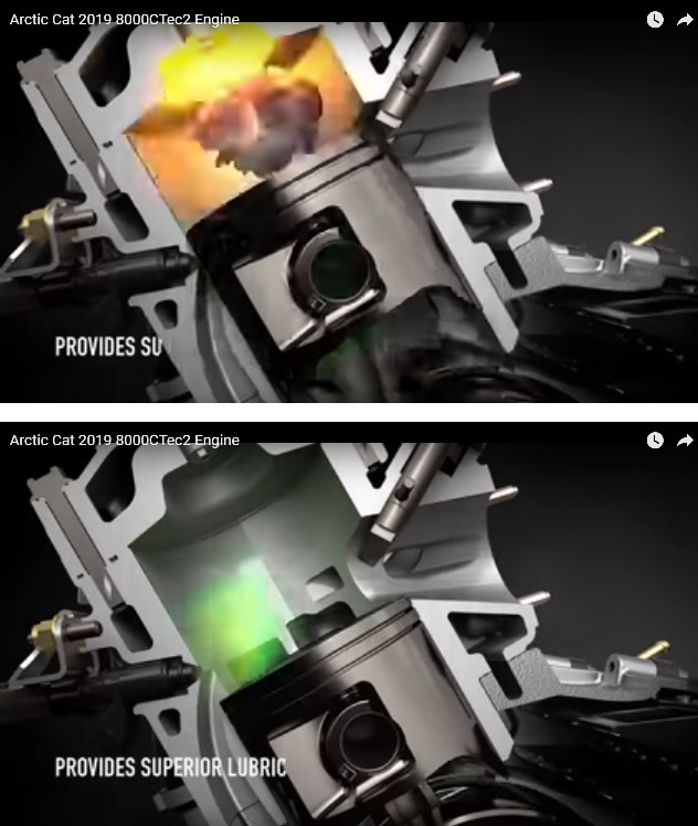

Here are two frames from the Arctic Cat 850cc / 2019 video:
In the upper frame the combustion continuous with the exhaust port already open.
In the lower frame it is shown the shape of the “combustion chamber”, the ports and the way the lubricant is provided.
The combustion chamber shape is, more or less, as in the following PatAT / PatBam:
With two-stage ignition (PatBam HCCI) the resulting low temperature combustion ends a few degrees after the TDC, several dozens of crank degrees before the opening of the ports.
The asymmetric transfer continues after the closing of the exhaust (quite important for the emissions).
The lubrication of the crankcase is four-stroke.
The lubrication of the compression piston rings is by abutting on the cylinder liner area wherein 180 crankshaft degrees before it was abutting the oil scrapper ring.
The engine runs un-throttled (as a Diesel) on lean air fuel mixtures: the lighter the load, the leaner the mixture.

The E-TEC (of Rotax / BRP / Evinrude) was, at its time, a breakthrough for the 2-stroke engines.
In comparison, the three modern 850cc 2-stroke snowmobile engines (Ski Doo, Polaris and Arctic Cat) have only minor improvements (“obvious to the skilled in the art”: a phrase quite common in the patent offices), nothing really innovative / impressive / exotic.

Hi Manolis,
There seems to be nothing particulary remarkable about the combustion chamber of the Arctic Cat,
& or piston shape design, since it features no projection into the C-C, unlike your design.
However, they do use a 'boost port' injection set-up, similar to what Yamaha patented over 45 years ago,
for their GL 750/4 2T roadbike, which sadly, never went on public sale, except as a (carb equipped) racer.
