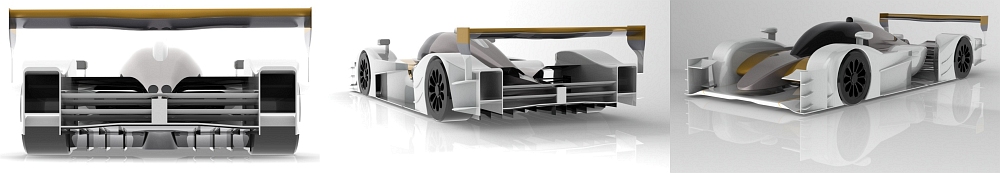

Here is the latest version of the TR18. Could not achieve perfect balance.

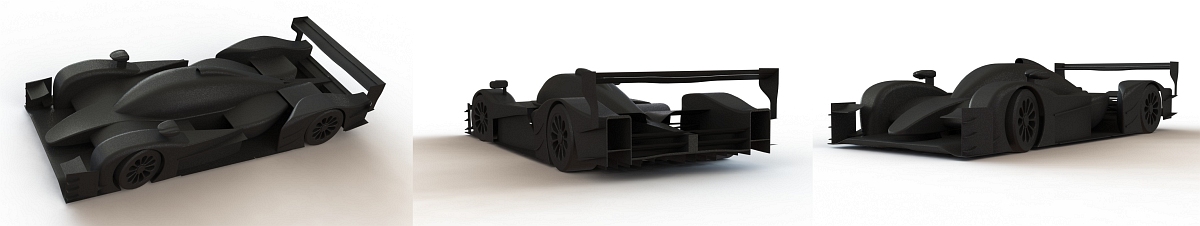

Here is the car for Daytona:
https://www.caedevice.net/SERVER/MVRC/2 ... aytona.jpg
- shorter sidepdos
- hidg downforce wings
- winglets
- "beam wing"
That looks brilliant compared to my car, which is:
However how rubbish it looks, it sets a new downforce record for the team since the beginning of the MVRC.

Ft5fTL wrote:
27 Jan 2019, 15:51
CAEdevice wrote:
26 Jan 2019, 19:42
- shorter sidepdos
- winglets
- "beam wing"
https://i.imgur.com/OZ5j0fH.png
https://i.imgur.com/8q4R4OE.png
It doesn't look rubbish at all

CAEdevice wrote:
26 Jan 2019, 19:42
- shorter sidepdos
- winglets
- "beam wing"
Cool! If that is as fast as it looks, i'm in trouble!
Talno's and Pure Power's cars look very solid too.
Maybe i'll release a render too, later. But the car doesn't look so different... I could have worked on it much more, but exams got in the way.

Ft5fTL wrote:
27 Jan 2019, 15:51
That looks brilliant compared to my car....
Looks good to me... nothing obviously wrong about it... 👍👍👍

TalnoRacing wrote:
27 Jan 2019, 14:16
https://s284.photobucket.com/user/Talno ... b.jpg.html
Looks sleek, 😎👍
