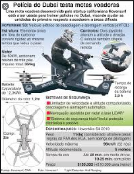

Hello all.
Thanks Gruntguru for the video:
Quote from HoverSurf official website at https://www.hoversurf.com/orderyours :
Scorpion S3:
The weight of the hoverbike is 114 kg (253 pounds)
Hoverbike S3 2019 contains this hybrid type battery with a capacity of 12.3 kWh, which allows you to fly (up to 40 minutes in the drone mode. The actual flight time with the pilot is between 10 to 25 minutes dependent on weight and weather conditions.
New engines with increased power to 33 kW each.
New 3-bladed carbon propellers are quieter by 10% than double-bladed propellers, smaller in diameter by 5 cm and give a total thrust of 364 kg (802 pounds).
End of Quote
According the following image (is there a better / clearer version in the Internet?) :
each of the four rotors of the Scorpion S3 is 1.2m in diameter.
So,
each 1.2m diameter rotor, powered by a 33kW (45bhp) motor, provides up to 364Kg / 4 = 91Kg (200lb) thrust.
Un-ducted.
Thanks
Manolis Pattakos
