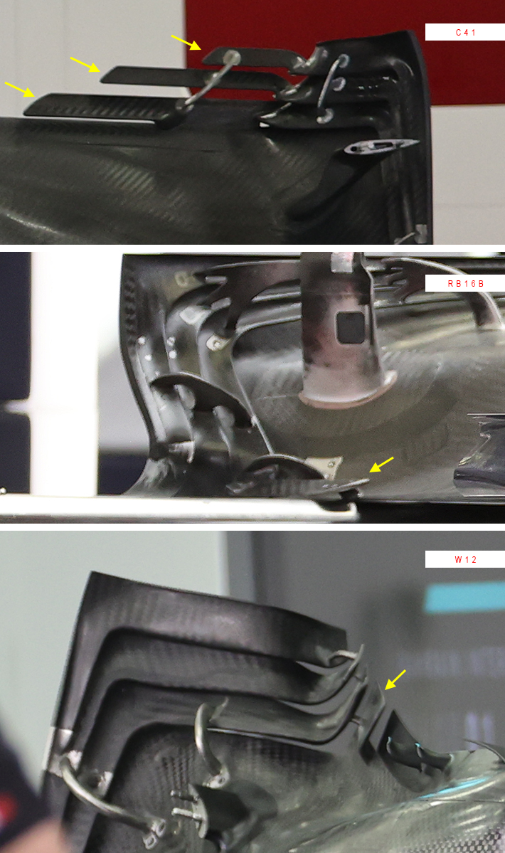

Nicolas Carpentiers wrote:Highly detailed aero work in the rear wheel floor area from Alfa Romeo technical team (led by former chief aero Jan Monchaux). IMO, the C41 is the only 2021 F1 car with such parallel vanes in this area. Red Bull has a long one, and Mercedes a short one.

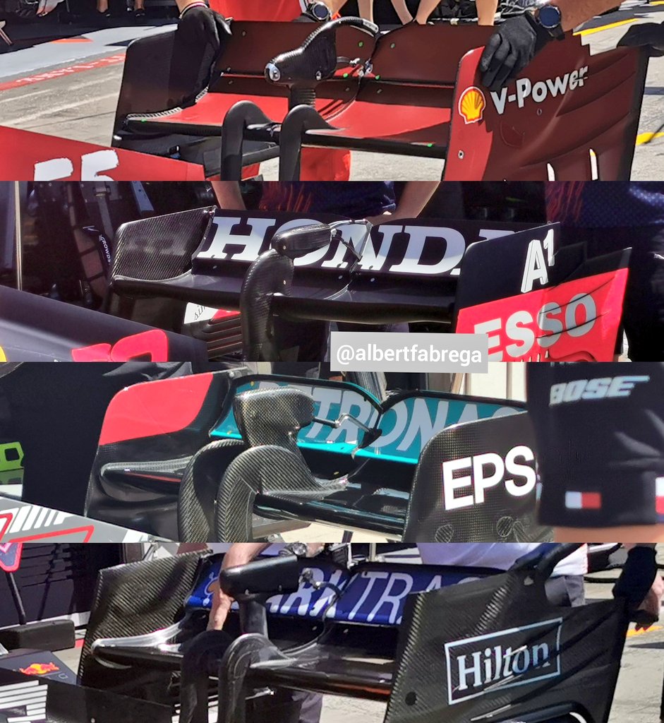

Styrian GP rear wing comparison
Stu
Joined: 02 Nov 2019, 10:05
Location: Norfolk, UK
Re: 2021 car comparison thread
Morteza wrote:
25 Jun 2021, 18:19
https://pbs.twimg.com/media/E4uDrXxXIAM ... ame=medium
Mercedes seem to be running a more aggressive wing package than the others (in particular Red Bull, but still more than either the Ferrari or Maclaren); this has been a bit of a theme of late.

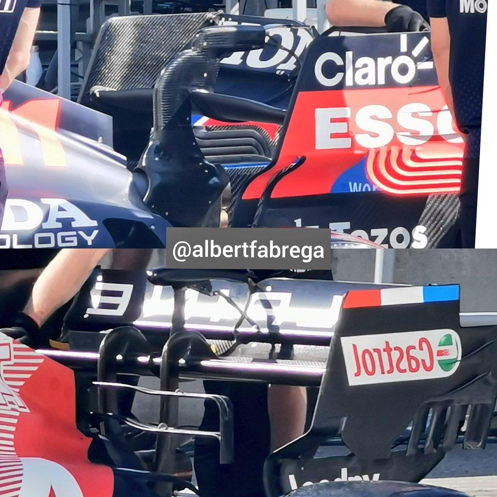

Rear wing comparison - Hungary

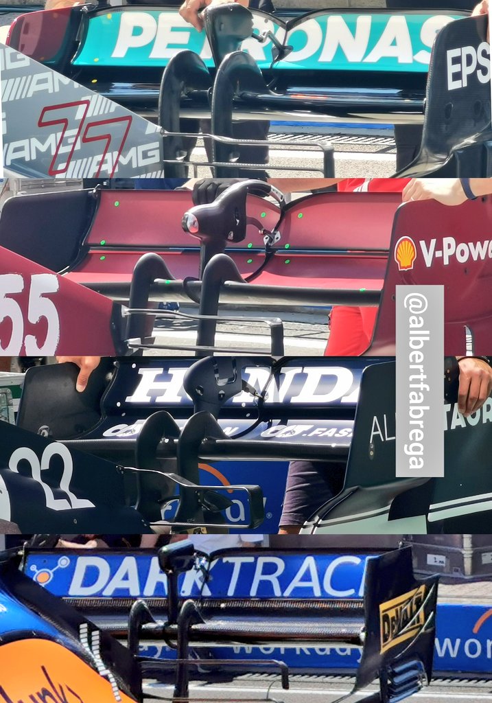

Rear wings for Monza

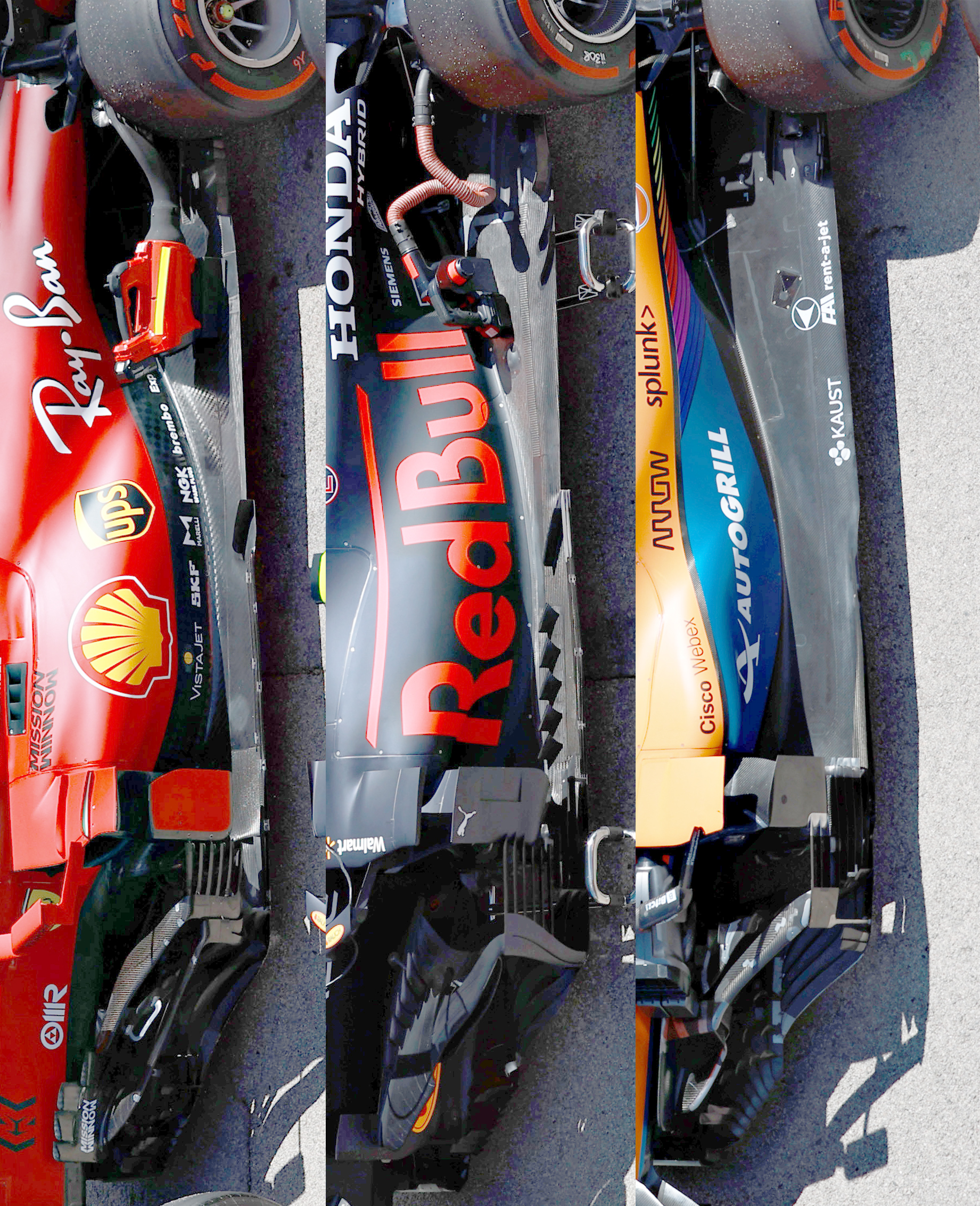

Rear engine covers for all cars for a warm Monza via @SomersF1
