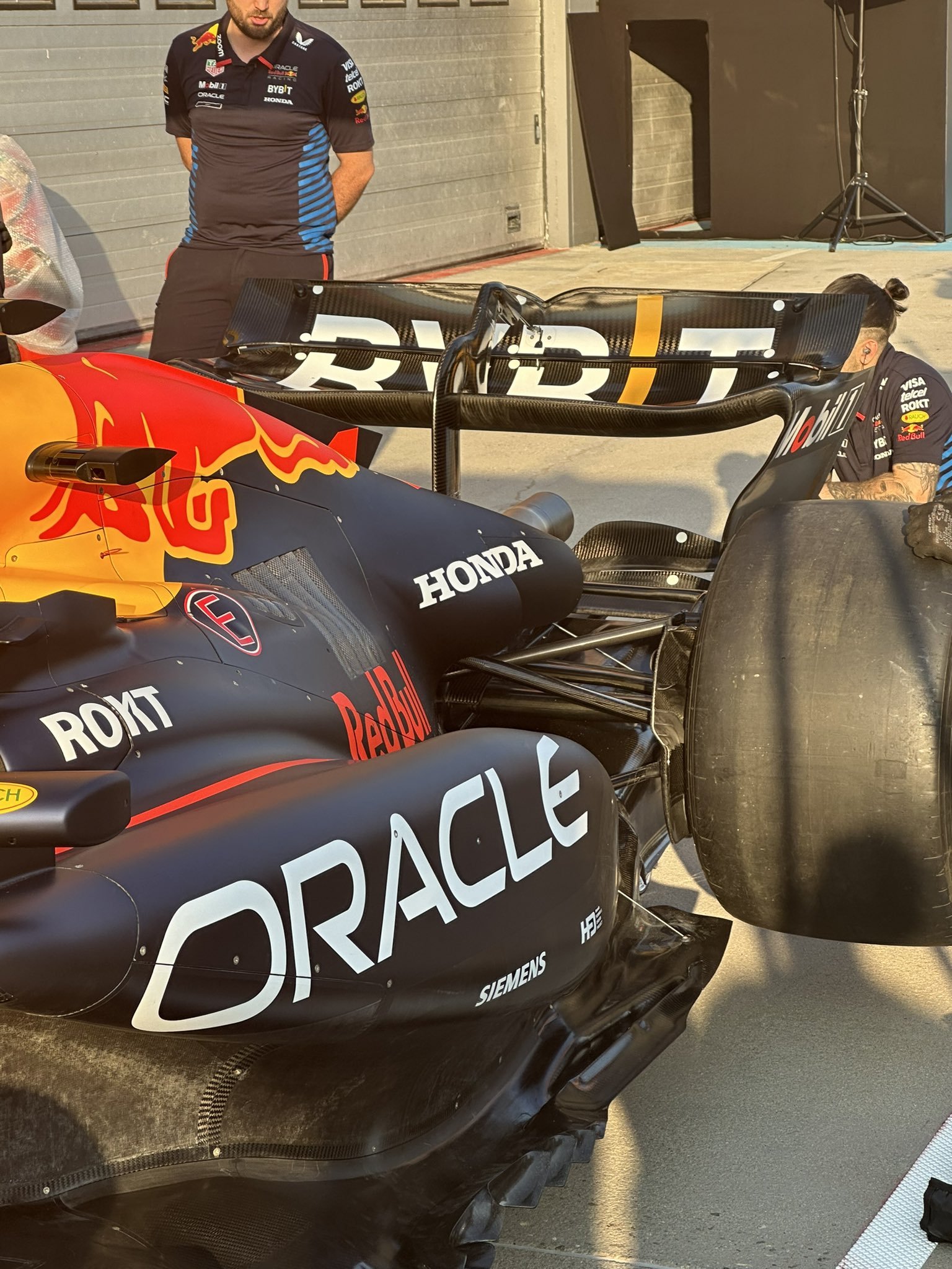

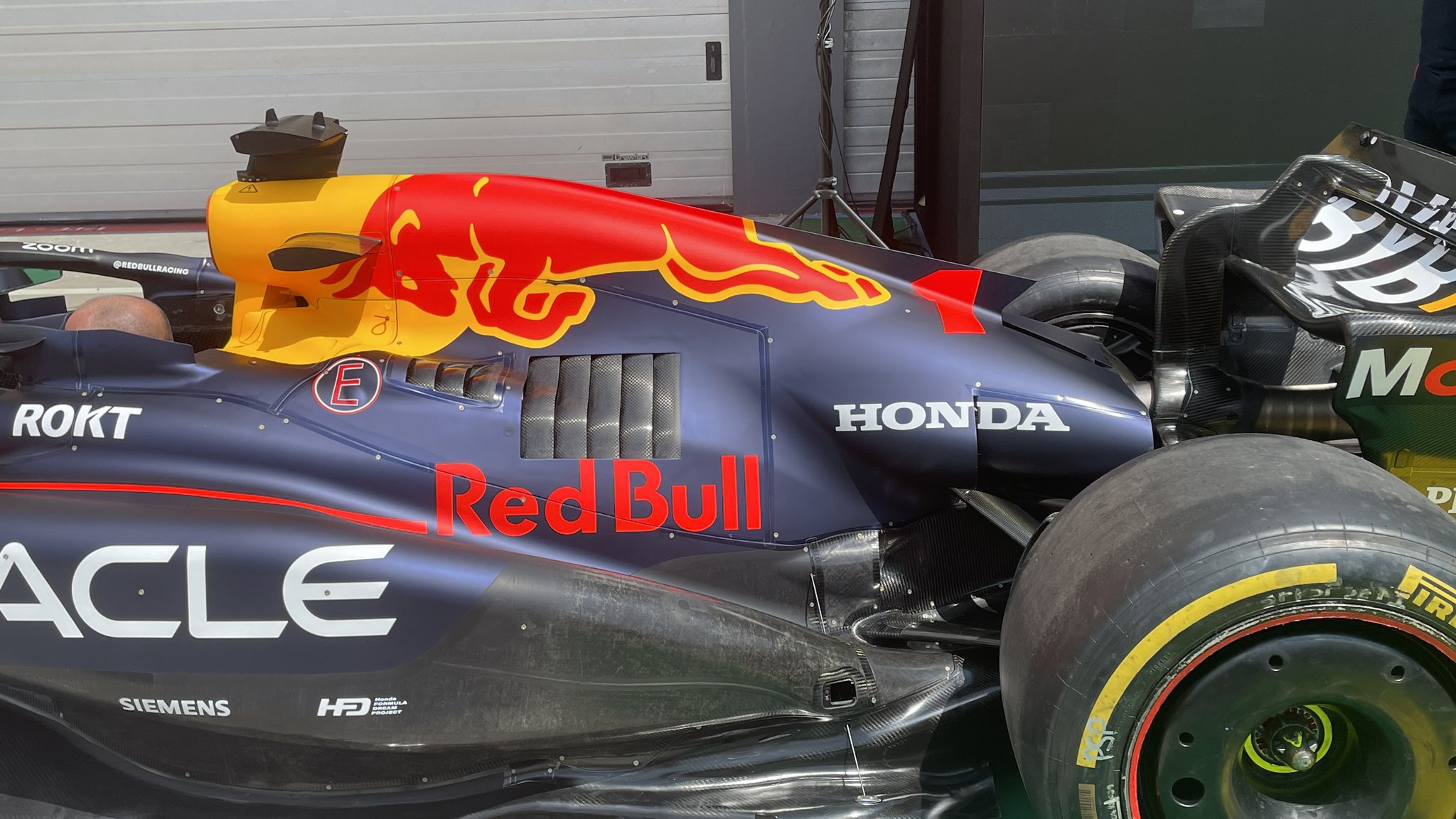

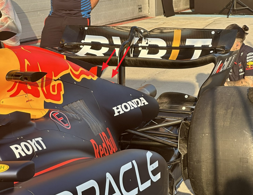

Other than the obvious cannon outlet change, sidepod walls are higher in the rear (around L and E of Oracle logo) and I'd say the top sidepod indent is more pronounced with this spec, the gully under Rokit logo is definitely deeper than before. Looks like an increase in pressure recovery everywhere on the bodywork, ie less bodywork lift
EDIT: yup, decent changes on sidepod top surface (right - new parts)
Also looks like a big rework of internal aero bits

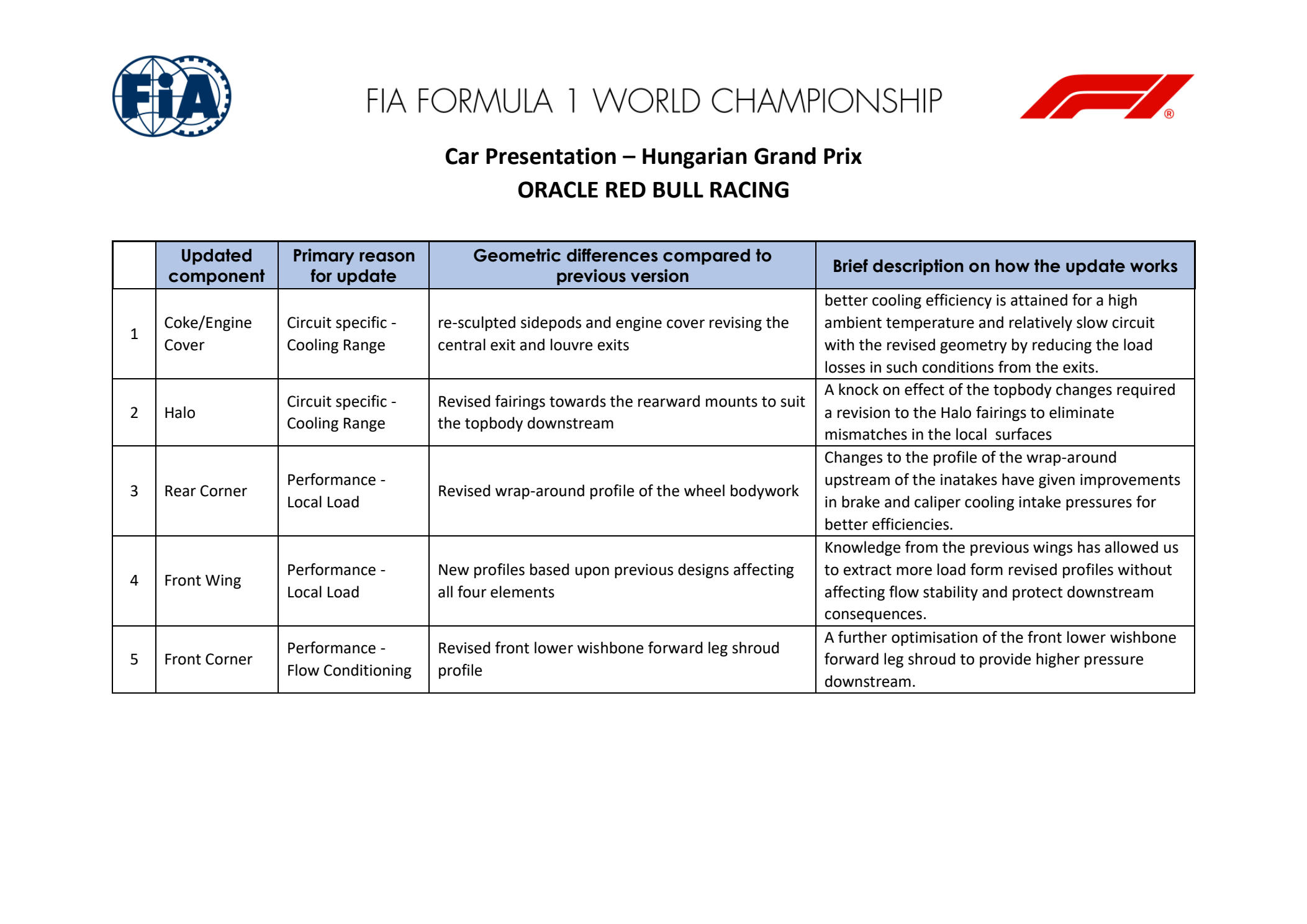

Looks like significant increase in rear brake vent entry cross section too.
Possibly to keep or reduce any brake temperature transfer to wheel rin at minimum, preventing excessive influence in tyre temperature.

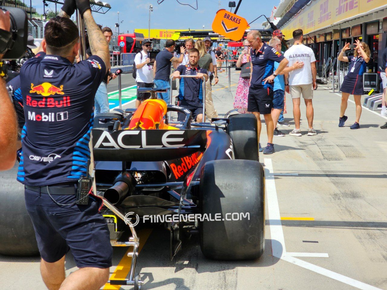

Behind Halo inlets are gone

Front wing and nose completely new, nose tip more rounded, wing scoop slightly reprofiled, outboard angle adjusters

The inlets behind the driver were quite large, where has that cooling capacity gone?
