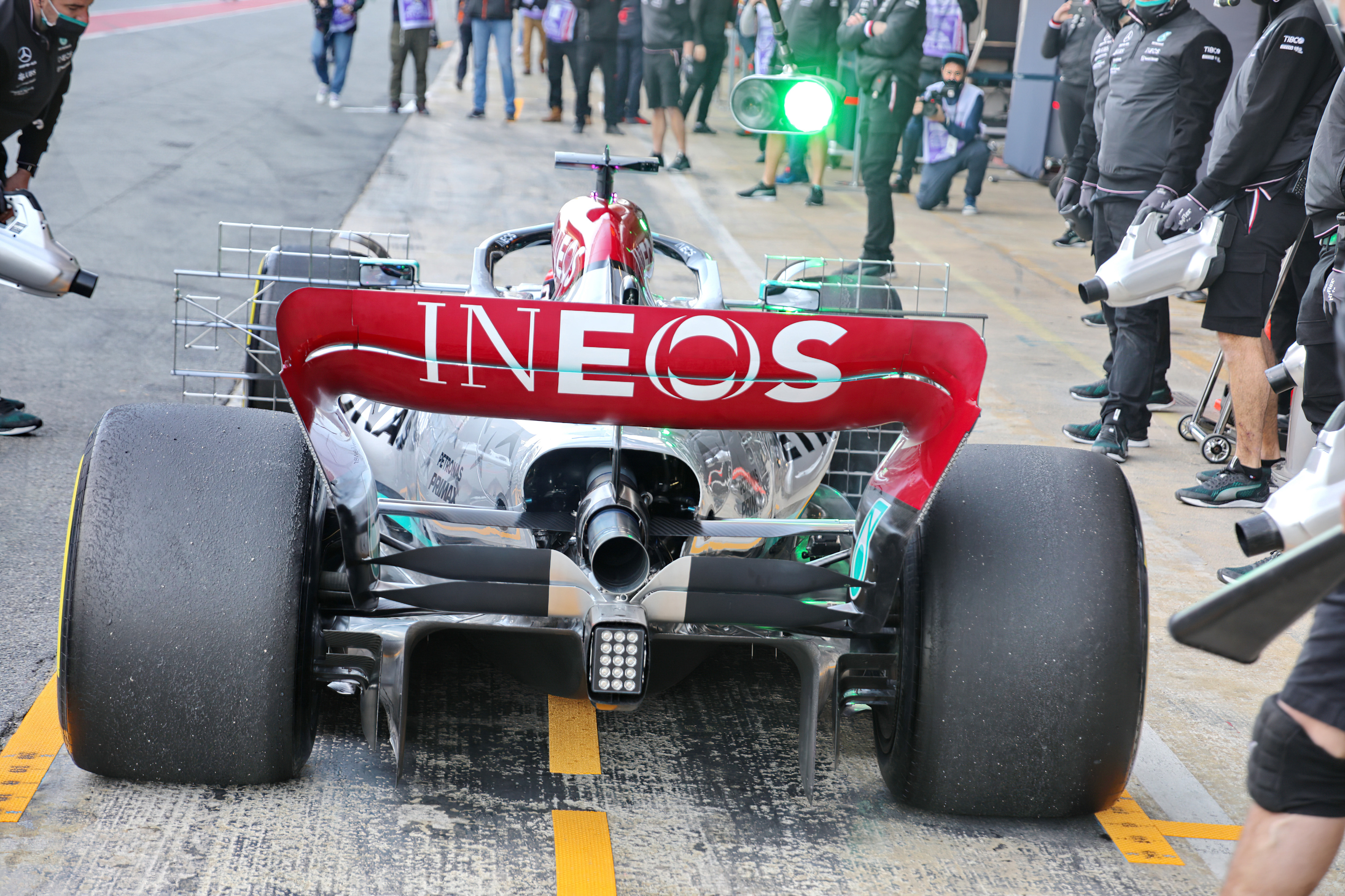

this one?
Offtopic: For me this years Mercedes beam wing look more like McLaren suspension blockers
https://pbs.twimg.com/media/FMRhfsSXMAY ... =4096x4096
Yeah the Mercedes is the one who looks most like the McLaren
