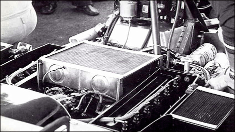

Can someone identify this car? and have other images of the same.

WilliamsF1 wrote:Can someone identify this car? and have other images of the same.
https://www.highpowermedia.com/Content/ ... diator.jpg
It looks like Mansell's 1983 Lotus 94T

Re: Heat Exchanger Arrangements over the years
Was this a dual radiator setup? That looks remarkable small.
The Arrows A10 had a radiator on one side and an intercooler on the other side.
