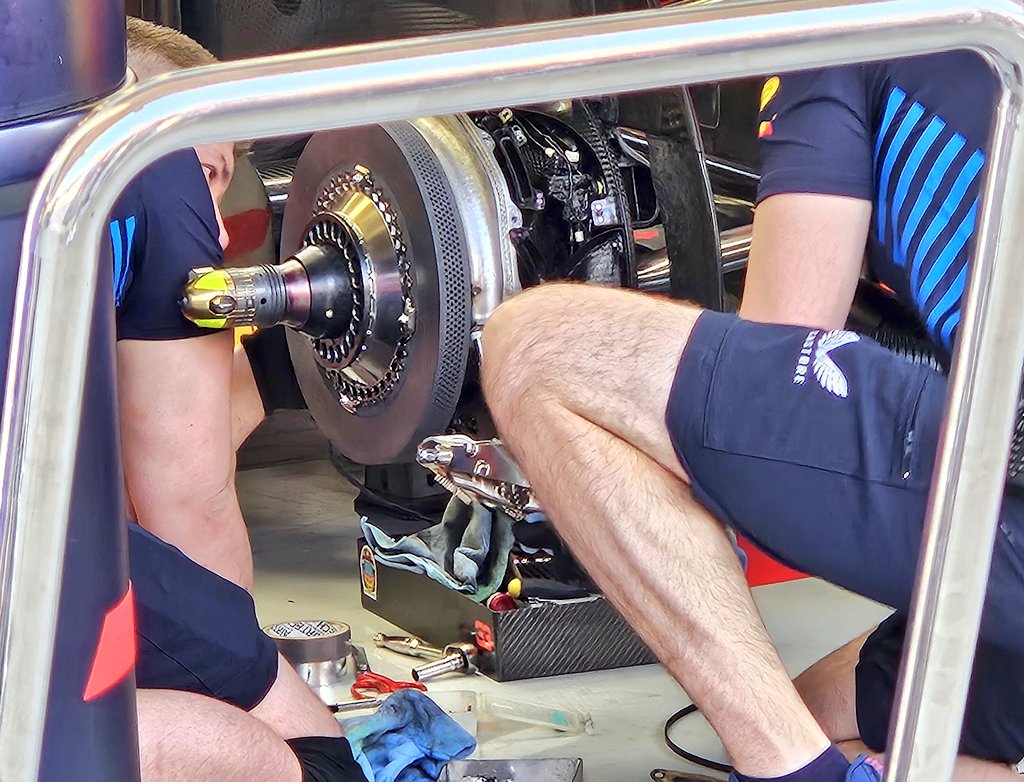

Bumpy calipers again (c. Fabrega)

Rb20 calipers in pic 1

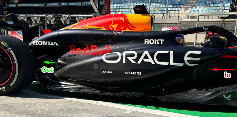

I would asume the vertical inlet goes to the sidepod cooler. The horizontal inlet looks to small to allow enough air. Just an assumption.

Re: Red Bull RB20
Re: Red Bull RB20
outlet has been there relatively unchanged since launch spec rb18. Other teamms have had outlets there and got rid of them too eg f1-75. internal ducting might've changed in the area though
